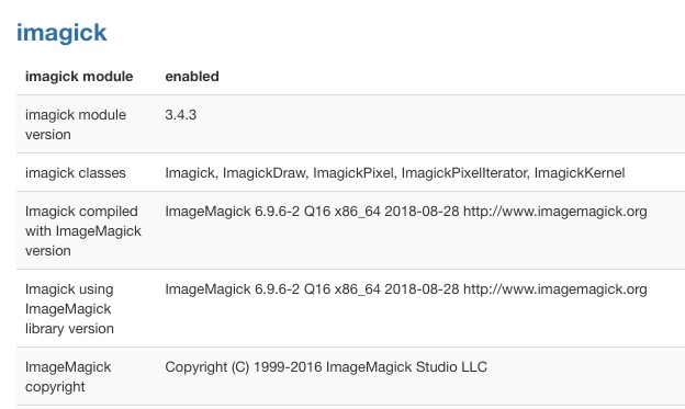

I am having the same issue on Joomla 3.9.1, JCE version 2.6.33. I believe the issue is with the resizing. I have an image that is 2.5MB and it uploads with no problem in JCE Image Manager and Media Manager. When I try to upload and resize with JCE Image Manager Extended, I get the error:
The server returned an invalid JSON response.
Go to System -> System Information -> PHP Information.
Scroll down and look for imagick (see below)
If you don't see this, speak to your host about enabling PHP IMagick on your server.
https://cdn.joomlacontenteditor.net/tmp/87625-uploading-images-invalid-json-response.jpg
more than a month ago
#97644
Thank you for the quick response. In my case it was a local ini file that was overriding the server default settings for the memory_limit. It was set to 32M. The ini files was removed and all is well again. :)
