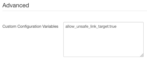

I understand why the rel="noopener noreferrer" was added to the editor but is there a way we can still open in a new window and not use this? This is messing with our CDN files. The site we are using is an Internet and only a few people can add/edit the site. We have always opened our PDFs in a new window as it helps the employees. Now we cannot. Our CDN is looking for the referrer to pull the file and with this we do not have it.
Can this be easily removed? Or is there a way that I can remove the rel="noopener noreferrer"? If so will it have to be removed with each update? Or is there another workaround without having to manually edit the article HTML?

This is added to links when the target is set to "_blank". See - https://dev.to/ben/the-targetblank-vulnerability-by-example and https://mathiasbynens.github.io/rel-noopener/

While this is done not by JCE, I will use RegularLabs DB-Replacer.
But it should be nice to build an Info in the change-log, that
1. this is new code to avoid phishing
2. the change of existing links must be done by the user/webmaster.
3. also the allow_unsafe_link_target:true parameter should be documented.
