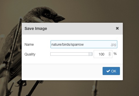

Thank you, this did the job. Another question: is it possible to save a thumbnail or edited image in another folder right away? When I edit an image and save it, I can only change the filename, is it possible to directly save it in another folder?
I have a gallery that loads all images from a folder but sometimes I want to create a thumbnail of one of those images and not show that thumbnail in the gallery, so I want it saved in its own folder, e.g. 'thumbnails'. Can this be done?
The Thumbnail Editor in the Image Manager Extended dialog allows you to create thumbnails, then save them to a thumbnails folder.
https://www.joomlacontenteditor.net/support/documentation/image-manager-extended/thumbnail-editor
I have also added the option to include a path in the image name when saving an image in the Image Editor in JCE Pro 2.6.27. You can try RC3 here - https://www.joomlacontenteditor.net/downloads/editor/item/jce-pro-dev
