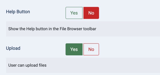

Please try JCE Pro 2.9.97 RC - https://www.joomlacontenteditor.net/downloads/editor/pro/development
There is now a Help Button option in the parameters for all dialogs that use the File Browser, eg: Image Manager etc. which can be set to No.
For example, for the Image Manager, go to Editor Profiles -> Plugin Parameters -> Image Manager, and set the Help Button option to No.
ebura
It works great!
