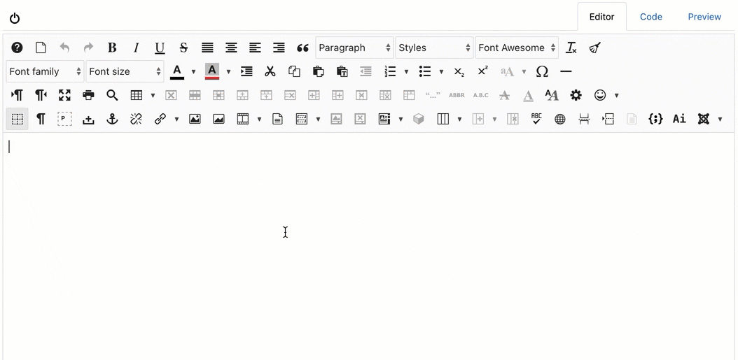

The only way to retain mixed HTML and shortcode (which in relation to HTML is not actually code, just plain text) is to use Code Blocks in JCE with Custom XML support.
Go to Editor Profiles -> Editor Parameters -> Advanced, and set Enable Code Blocks to Yes and Allow Custom XML to Yes.
In the editor, select XML from the Format list, then in the XML Code Block, type in:
<rsform>
paste in your code, then type in
</rsform>
This will preserve the code, and allow RSForm to process the shortcode tags.
