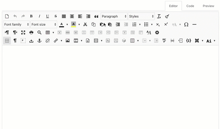

we're using regular labs users anywhere, and we are using the {if} condition to output or not, a link to import a script or link to a css file..
and its fine in the Code Tab, but when we go to the editor tab, then go back to the code tab -- the editor adds html markup, and strips out the css links - we already setup jce to not validate html, and told joomla no text filtering.. anything else?
we did try on other thing we added <code></code> and it seem to work , but the editor tab wouldnt load at that point anymore.
As the editor is primarily an HTML editor, "code" like this {user id="input:uid"}, which is not HTML code, is treated as text and processed accordingly. JCE does have an option to attempt to protect shortcode like this, but it does not work very well in multi-line scenarios llike yours.
In addition, the combination of script and link elements, which must also be treated slightly differently to regular HTML for security reasons, complicates things.
The best way to deal with this is to tell the editor that this is all custom xml code, and to therefore ignore it. To do this:
  1. In Editor Profiles -> Editor Parameters -> Advanced, in the Code Blocks section, set:
    1. Enable Code Blocks to Yes
    2. Allow Javascript to Yes
    3. Allow CSS to Yes
    4. Allow Custom XML to Yes
  2. In the editor, select XML from the Format list (the last item) to create an XML Code Block.
  3. In this code block, create a custom XML container, eg: <custom></custom> and paste you code into this container.
  4. Press SHIFT + ENTER to exit the block
This will then protect your code, but the browser will ignore the <custom> tag in the front-end.
