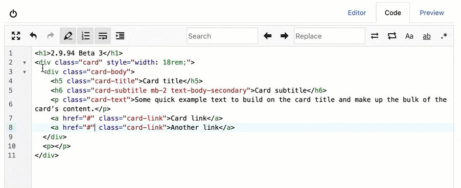

Repro: Open JCE Editor → switch to Code view → place caret on <div> → expected: matching </div> is highlighted; actual: no highlight.

This is what I am seeing in my tests, first with JCE Pro 2.9.94 Beta 3, then JCE Pro 2.9.89
