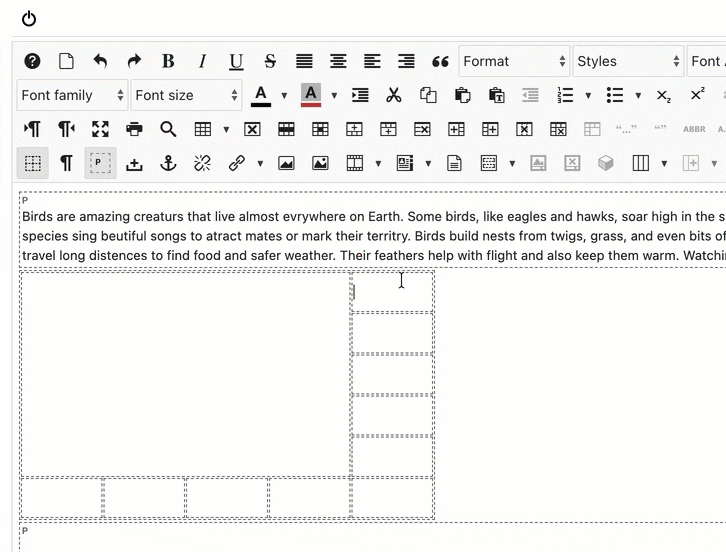

 bei der Zusammenfassung von Zellen in einer 5-spaltigen Tabelle, wird die Tabllenstruktur zerstört, wenn die letzte Zellenspalte zusammengefasst wird..
When summarizing cells in a 5-column table, the table structure is destroyed when the last column of the cells is merged.  see: https://www.screenpresso.com/=Pftdrs9Yqb6y

HGH
That doesn't  work here.
Should I send You my test-table?
This is my test:

Hi Ryan,
I tested it again with  JCE Pro 2.9.99.3 and have to say that it was my mistake. The reason the cells collapsed after summarizing the last column-cells is that I hadn't specified the cell height and the table height. Now that I've done that, everything works. see: https://www.screenpresso.com/=EqVEIy0FZ7Rk
