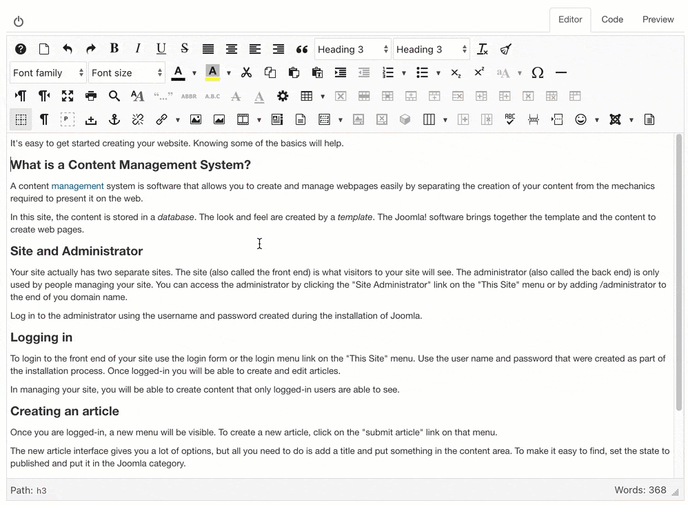

I've had to tweak the Columns tool a bit to get this to work, and I have uploaded the updated version to your site. So you can attempt to create the columns and TOC as explained above, eg:
- Select all the content using CTRL + A, then click the Columns button.
- Set the number of Columns to 1, then click Insert.
- Click anywhere in the content, and click the Add Column button to create a new column to the right.
- Click in the new column and click the Columns button, then select a Layout value of 3-1 or 2-1, and click Update.
- Set the Stack Width option to Small
- Click at the beginning of the new column and click the Table of Contents button.
I've create a simple Table of Contents plugin, which may do what you want - https://github.com/widgetfactory/jce-editor-toc
In the video below, I've used Columns to create to position the Table of Contents to the right of the content, eg:
If you change any of the headings, click the Table of Contents button again to update.

The button is only enabled if the editor content contains Headings, eg: h1, h2, h3 tags.

Looking at the "test" article on your site, I don't see any issue with the Table Of Contents layout or positioning. Please be aware that the columns will wrap or "stack" depending on the Stack Width option you have selected for the Columns, which you can edit in the Columns dialog, and the width of the area that the content is displayed in.
To prevent stacking, set the Stack Width to Large or Extra Large, and be sure to preview the article on the front-end to determine how it will actually look, as this layout may be a different size to the editor width.

You need to add the readmore break before the content that is to be included in TOC, as when Joomla renders the content in the front-end, the readmore will break the layout.
It looks like you've got it right here - https://www.forteinnovations.com/insights/crypto/debunking-the-crypto-myths-that-frustrate-most-people.html
