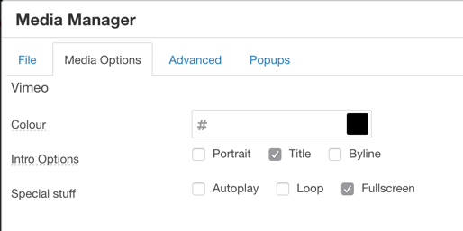

These are for generic parameters that can be passed to the popup media item, such as attributes for a video tag, eg: controls, autoplay etc. For Vimeo or Youtube, these would refer to the Vimeo and Youtube options eg: Portait, Byline, Title, Autoplay etc. (for Vimeo) or Autoplay, Loop, Start etc. (for Youtube). These are not yet supported for Vimeo, but will be in the next MediaBox update.
It is sometimes easier to create a Vimeo, Youtube or Video popup using the Media Manager dialog instead of the Link dialog, as a Media Options tab is available to set properties for video. https://cdn.joomlacontenteditor.net/tmp/100534-mediabox-popup-parameters.png There is unfortunately a small bug in this for Vimeo, but this will be fixed in the JCE Pro 2.7.15 update this week.
